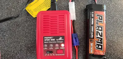

Does anyone know what amp i should put this charger on for t15613947130215535627284555445618.jpghis battery in picture ?

Rule of thumb for charging is 1C, unless otherwise specified by the manufacturer. Your battery is 2000mAh, so charge at max 2A. This will charge it in about an hour. Keep in mind that the temperature should be monitored as you charge, if the battery is getting too hot it will damage your battery. Generally speaking, charging at a lower rate should better the life of your battery.

I used to charge my Nicd and NiMH batteries at 4 amps, alot less danger of these types exploding and causing fires or any of that jazz......
Back in the 90's I used to charge my NICD race pack for my onroad car at 9 amps and run them hard for 4 minutes, never had a failure with those packs.....

Thanks guys this is a great site, you guys are so helpful.thanks again
