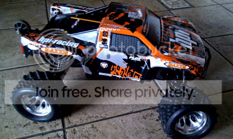

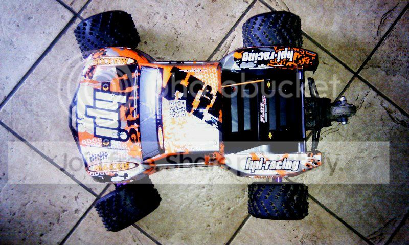

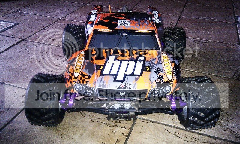

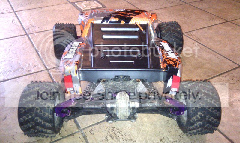

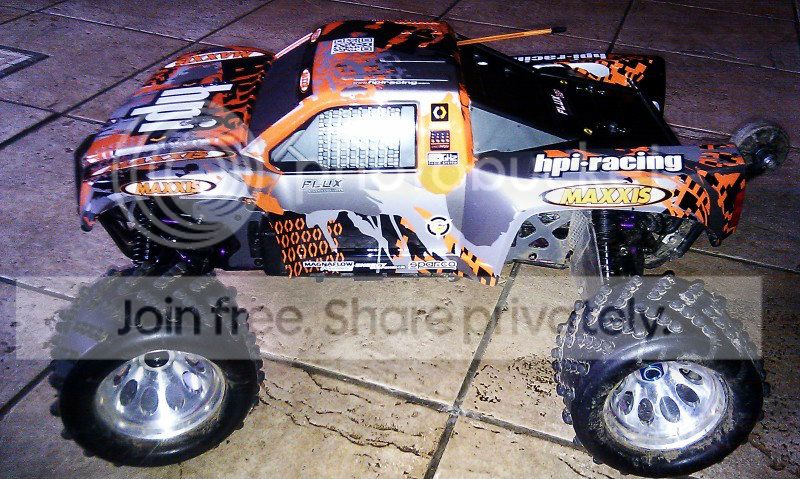

Nice! I gotta ask you though - with the wide axles and the way offset rims, thats a VERY wide stance - how well does it handle? Good turning radius?
it turns real good, way better than standard. i wouldnt go back. goes round corners on power or with a power slide easy no more tipping over. I'm running 22pinion 44 spur with 140mm dia tyres on 1.5inch offset. its a xl length TVP's with xl axles and has a outside edge tyre to tyre width of 20inch. also I'm in process of converting to truggy styleee 17mm hex. only downside is wears bearings out, but for the preformance gain its worth it.
I would recomend Flux axles and you will see even better turning and you still shouldn't have an issue with flipping. If you do it can be resolved by lowering the truck so the arms are level at rest. You also won't go through bearings nearly as much
front arms are level and rear shock preloaded so that under power when it squats they are level or just under too.
bearings cost now't so I'm not bothered. like the width lol
