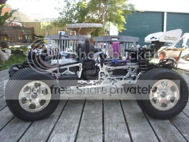

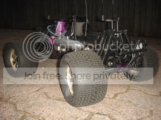

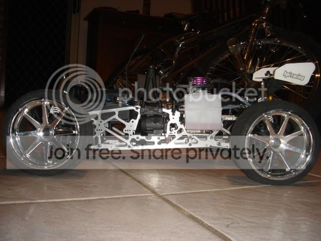

Here are some pictures to show you the height of each setup:
Stock Setup:
Hot Bodies Alloy W/25mm Internal Limiters:
Cen Genesis x4:
Cen Genesis x8:
IRC Shocks:
Well I hope I helped clear this one up and help everyone out guys!
