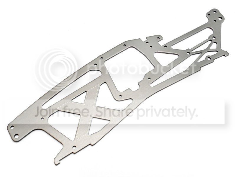

So today I noticed that my tvp's are bent...what are the strongest tvp's out there for replacement? My truck is a savage 25

Thanks... I was looking at FLM's. From what I've been told the TVP's on the X and XL will fit the old trucks as well (just might need longer dogbones for the XL). But for the cost of FLM I could buy 4 sets to X's of ebay.
I'm wondering if that makes more sense - I'm not sure if they bent because of a crash or because of the larger motor in it causing a lot of torque.
Well stock plates can bend if you do a lot of big air jumps and land no so well, one wheel landings can bend things out of shape in a hurry too. as does cartwheeling it some.... best thing you can do is to make sure all the screws are there and tight before a bash session and try not to land wonky will help a lot....
FLM TVPs are 4.7mm thick. IRC TVPs come in both 2.5mm and 4mm varieties.
This is a pic of the Savage 25 TVP and the FLUX TVP. As you can see, their is a difference. 2nd pic is side by side. 1st pic is the 25 on top of the flux.DSCN1153.webp DSCN1152.webp
