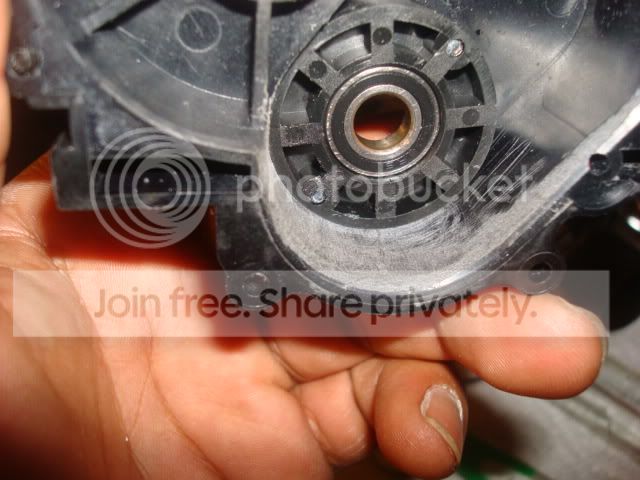

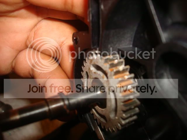

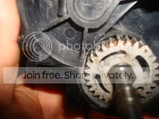

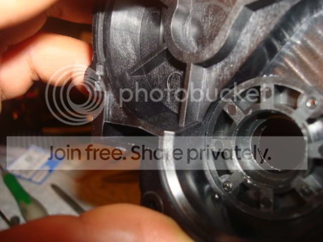

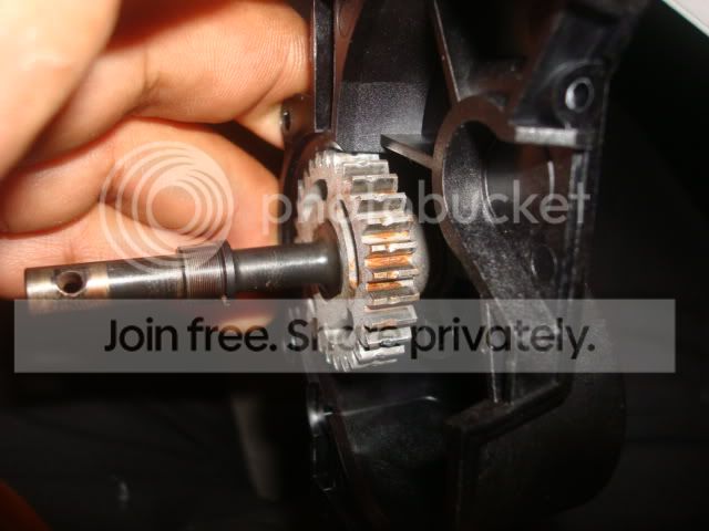

As I was changing out my bearings I found the idler gear was rubbing against the transmission case.
This is what you need to fix it.
Grind a little
