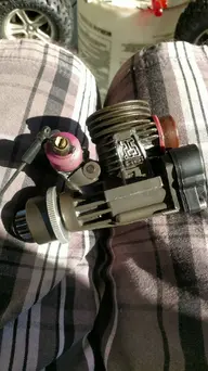

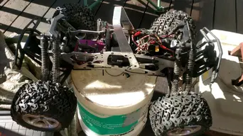

The glow plug glows red. Also fuel spits out of the heatsink where it connect to the top end. I cleaned it up. I had my friend take a loot at it and he plastic welded the cracks and covered with jb weld. Haven't put it together yet. Working overtime at work so not a lot of time to tinker right now. I've cleaned out most of the engine. Apart from taking the piston out.

Better off getting a new carburetor for the :ercm: the low end needle by the linkage bar is supposed to be flush, but it looks to be damaged severely by someone....
Also while the :ercm: is out you should replace the spur, it looks pretty chewed by something.....
Yeah came with everything. Came with 2 extra servos. I've got it started a couple times when I first brought it home just won't stay running. And what's the stock carb part number? Can't seem to find a carb on eBay other then one that fits a f4.6
The f4.6 and the 25 should be the same carb, owing both they look identical to me at least. Your piston looks fine as well, mine looks similar and Ive only had maybe 3-4 gallons through it so no issues there, if you wanted to you could try and take some of the carbon buildup off the top but its not necessary!
Ok I'll get the f4.6 carb and I'll also just clean everything out spotless. Thanks everyone. Hopefully I'll be able to play with this soon.
