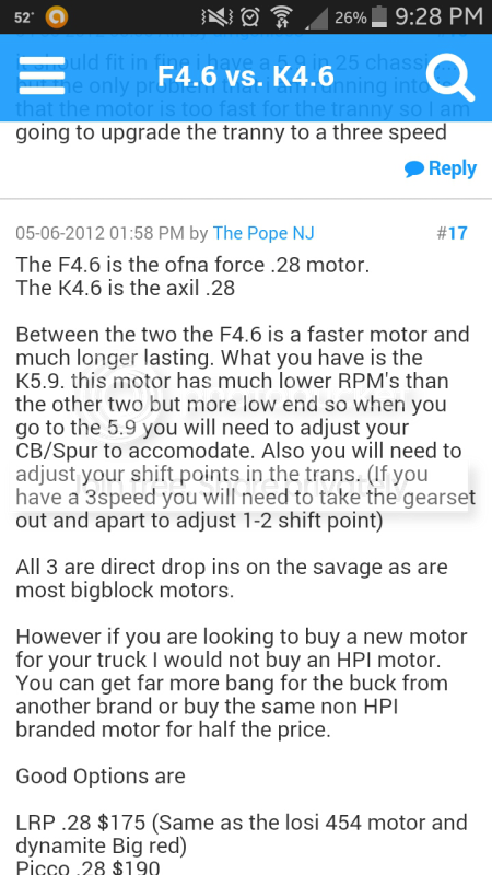

any one know if the green axial. 28 head will fit on this motor?
Well if ya have it onhand is easy enuff to try it out, if ya gotta buy it I would get the right head for the engine...

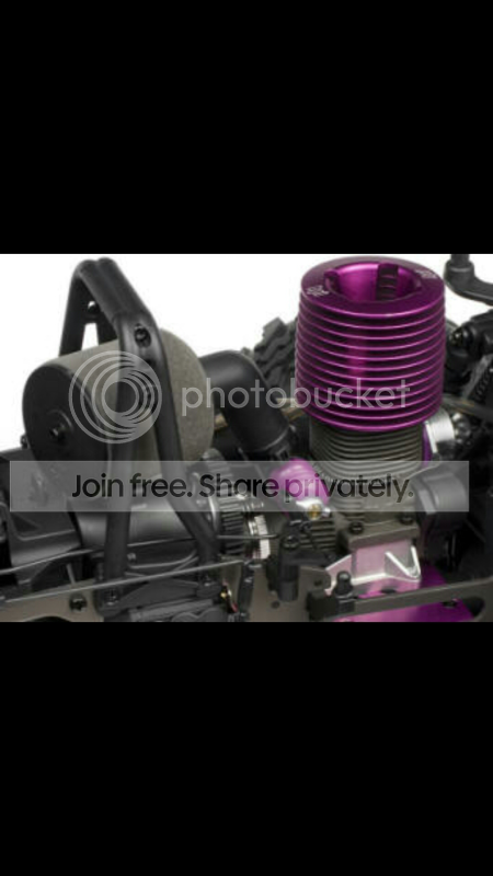

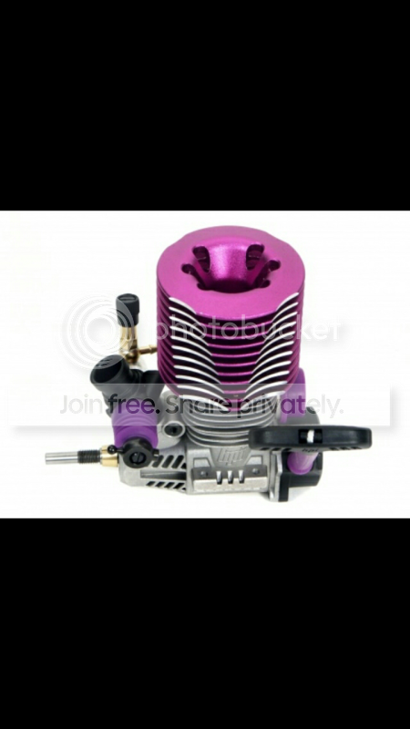

I just hate this purple! Trying to get rid of it all on my truck. and needing a new head soon so was think now would be a good time but looks like a no go.:mad:
If you want to get rid of the purple head on your engine, why not get the the grey head off a V1 F4.6 hpi engine?
From memory they are the same engine, just different cooling heads. If you have a buddy or some one you know with a V1 F4.6 ( grey ) savage, swap them to make sure it fits. But it has to be the version 1 head because the V2 will not fit.
Hope this helps.
