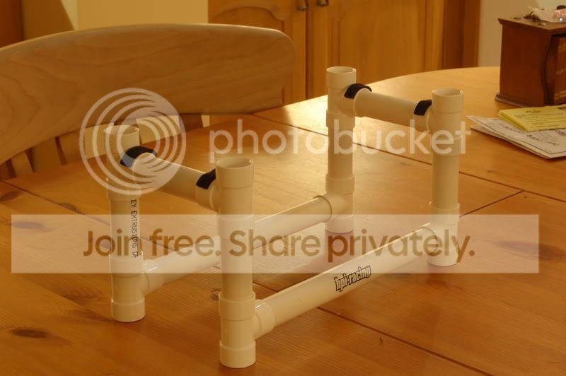

So there have been many different PVC truck stands built before. It seems as though everyone has their own take. Here's mine. I was looking for something simple, small, and easy to store when not in use.
Components:
8 T fittings
3ft 1/2" pipe
Tube cuts
2 - 3 1/2"
2 - 9"
4 - 1 1/2"
Glue a T on the end of each 9" piece of tube. Then a 1 1/2" piece of tube in the top of each T. Take the other T's and glue one on the end of each 3 1/2" piece. Then cut a slit in the bottom of each T that is on the shorter pieces of tube. Next put a screw through each slit. On to the pics since I can't describe everything too well without them.
A scaled down version of the other PVC stand, but it looks like it serves its purpose. Good job.

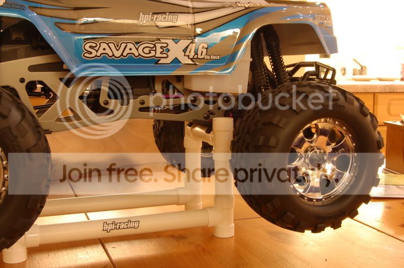

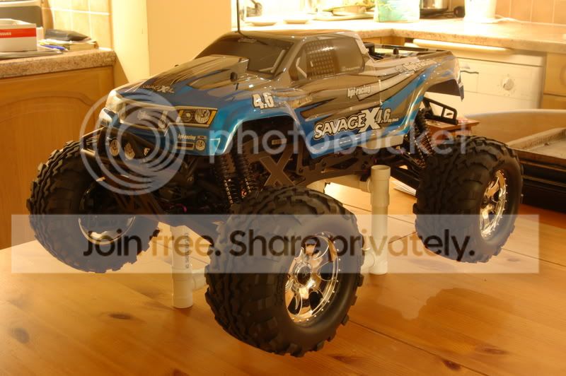

Well guys, i loved this stand so much I built one today, I didn't go for the folding option, just a good sturdy glued up stand, here's the results (can't believe how tough this stuff is - it's great!!!)

well, i've got to say, out of all the truck stands i've seen, that is the first foldable, that is one handy piece of work....+1:resp::duh:
