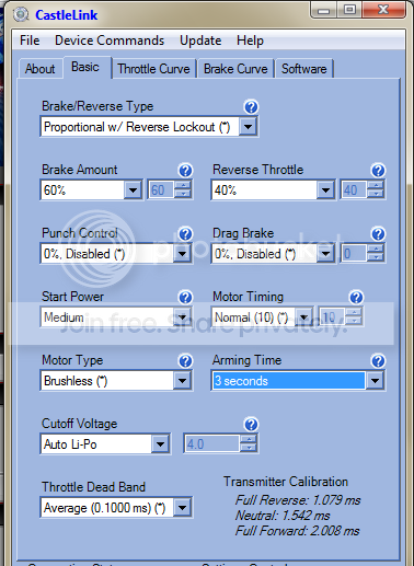

next question is how you have your esc set up with the castle link? my punch control is set to zero, whats is yours?

Here's my CC specs
I might up motor timing, see if that helps. My batteries are Turnigy packs. The 5S set is 4000mah, with 40-50c discharge.
if you want wheelies, flips and other acts of self-destruction, also up your start power.
also, consider backing down that braking power especially with the turnigy or other budget packs. i think mine is on 20% and its plenty.

Braking ok, I'll try that.
