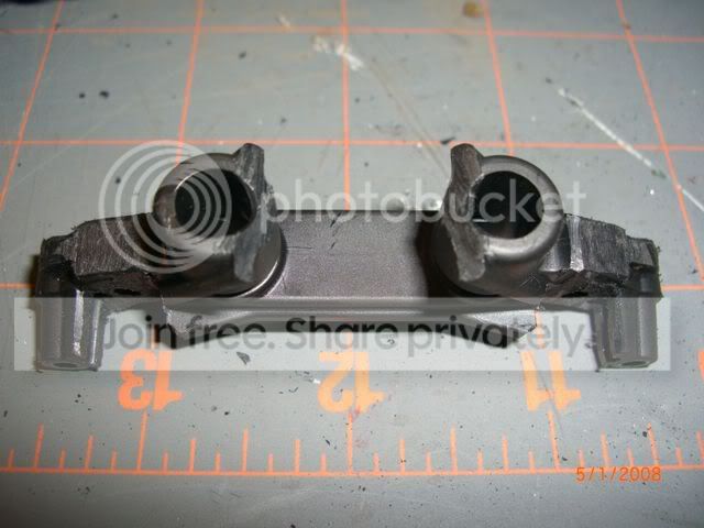

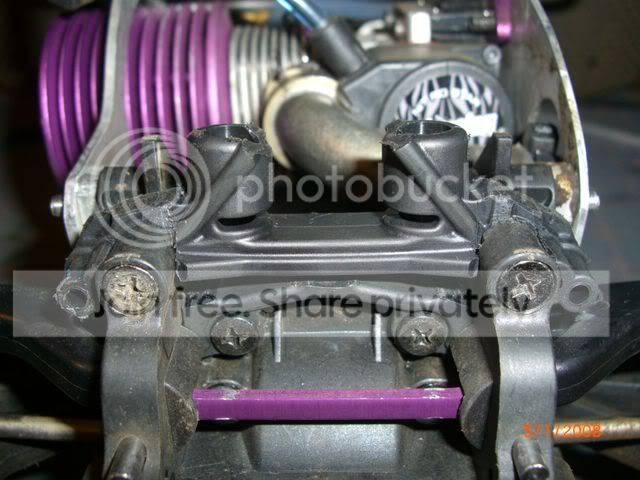

You can also cut some weight by trading down to some shorter shocks and lighter towers. Check this out, CF Hellfire towers mounted to the bulkheads on the tie-rod screw locations:
Or this, with Kyosho Inferno GT shocks and modded stock Savage X towers:
Ascender! + REP!!! thanks for that detailed description... Helps clear a few things up for me.. also great pics of modded shock towers and suspensioN!!! Helps a lot!
