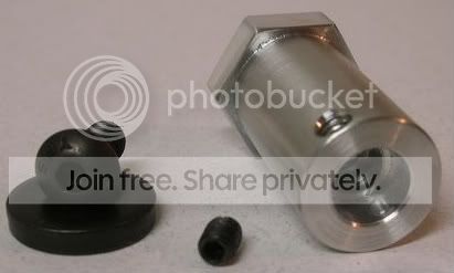

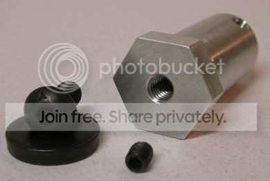

After looking at them and pulling out my drive cup, I decided I'd have a go at making them myself. Did a prototype this afternoon from aluminum, I might make them from steel next time and have them hardened, as I don't think they'll add THAT much weight and it will be much stronger!
First thing I noticed after I made the prototype is that the pocket inside the rims isn't exactly 17mm, they're slightly bigger so there is a bit of play between the hex and the pocket.
With my version, the extension actually screws onto the cup/shaft and also uses the dowel pin and set screw to hold it in place.

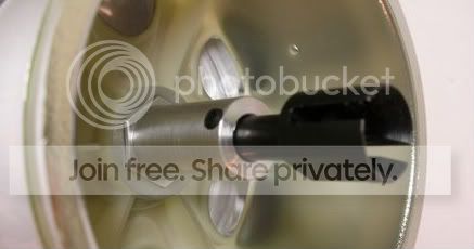

Got the first set completed and installed, snuck them in with some black anodizing at work :) Pics:

Started machining the real ones today, going with aluminum for now. All I had to work with was 6061, so we'll see how they hold up.
great work buddy!! I'm using the nova wheel extensions and love them so its nice to see someone with the know how to make them themselves!!
