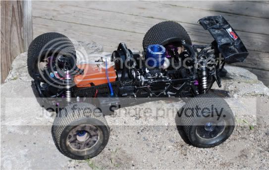

Here is a look at a purpose built race savage, full carbon fiber and aslight as possible for the best performance.......

that is all PRC. its from Larson racing a member here. you can find him in the vendor section. He is also post 8 and 13 on this thread

this truck is mine its 10 pounds in that pic - 11 with heavy tires
as far as durability http://www.youtube.com/watch?v=49bQ5mCjuJg Ive yet to hurt it... For scale I'm in the black shirt brown hat on the top of the jump/berm, I'm 6'4. Though stuff !

very true!!! dirt bonz are in that pic but I don't use them much at all... A offset rim helps the truck allot. I cant use full offsets like the spi's but love 1/2 offset like in that pic ... SPI should have them too I do imagine.
M411b: note the 1/2 offset on sams truck above that won the nationals. one of the best things you can do for stability like Matt (soulja55) says above.
